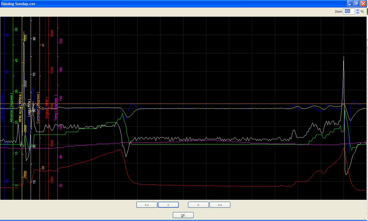

Well, I finally got my Duratec installed in the Escort. MegaJolt and all the bits working well.
For the vacuum camber in this build I used the old Duratec fuel rail with pieces of fuel hose instead of injectors, and it is working surprisingly well, I thought it may be a bit lagging because of the overall volume.
The map it's self is a very safe map, and has not had a true road run in yet but I feel its a good starting point for this engine and configuration. The advance correction is based on a warm-up style correction and the degrees C scaling was got off another members post somewhere on here. I cant find it again so will post it again here, with much thanks and credit to him.
Comments, Queries and improvements most welcome.

Modifications: ZX6R Bike carbs, 4 - 2 - 1 Exhaust, Standard cams and internals

- 80 seconds of runtime datalog
- Screenshot Datalog Sun19th.JPG (110.81 KiB) Viewed 11907 times
