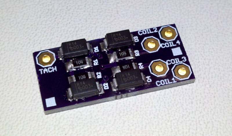

just got mine and it looks good, i really underestimated just how small it would be.
2 questions:
1. Will the solder used for the components melt at the temperatures used to shrink heat-shrink tube?
2. What gauge of wire would be suitable for hook-up?
cheers
Ian B.
In the lab or in the car

Brent, will this resolve the 4AGE tach signal problem?
Ian,
The solder won't melt at the temperatures used to shrink heat shrink tubing.
Not a lot of current flows through here - small gauge wire is fine and makes it more convenient.
A similar circuit works for my AW11 tach, so it should work for the AE86 tach as well.
Note, this board is not a cure-all for *all* tachometers out there. it has the addition of 100K resistors across each diode which helps make certain tachometers compatible - such as the 914 tach we're using in our race car: that tachometer wouldn't work with just diodes.

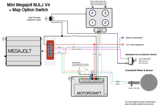

If your tacho works, but has a hissy fit bouncing around at higher rpms.
Would this adapter help ?
Toenee,
Can't say for sure. How is it wired now? More info would be helpful.

Sorry yes more info needed, it's wired to the megajolt as per the diagram
toenee, it would probably work- especially if the tach was connected to the (-) of the original single coil.

brentp wrote:toenee, it would probably work- especially if the tach was connected to the (-) of the original single coil.
Yep it's a RVC tacho from a MGB, just put my order in cheers.
