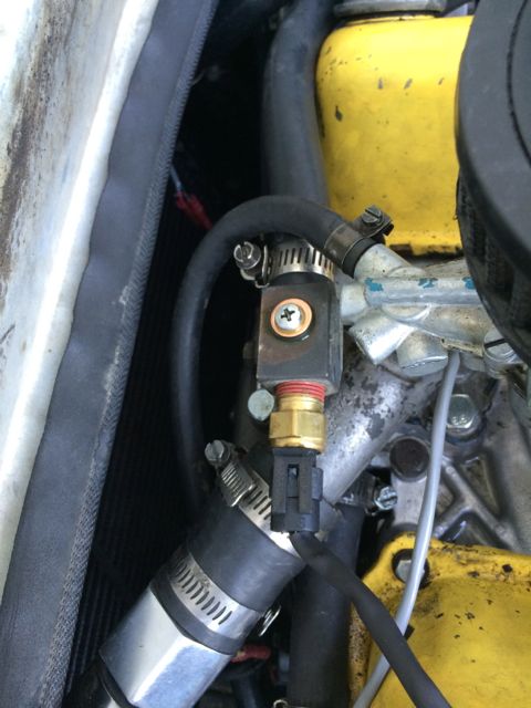

Re: temp sensor--I just used the recommended GM temp sensor available from this site. It is a 3/8" NPT thread, which happens to be the thread that the silly little PVS apparatus screws into on the thermostat housing (see first pic).
If you go this route, I highly recommend taking the whole thermostat housing off and fixing the elbow fitting in a clamp before attempting to get the PVS unit off. Though now that I think of it, if your engine was from a Euro 96, it might not have the US-mandated PVS unit in it in the same place. If you still have the in-line fitting, it's an easy way to mount it without drilling/tapping another location or messing around with the stock VDO sender.

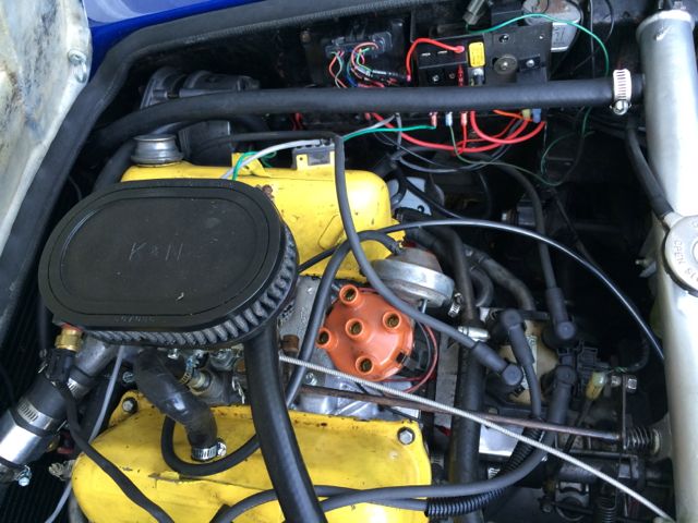

I used existing holes where the old voltage regulator (not needed with updated alternator) and coil were to mount the EDIS unit and a plate with a fuse panel hooked up to a relay to take care of power for the MJLJ/EDIS/coil pack. For the coil pack, I made a mounting plate that attaches to the bellhousing bolts behind the stock dizzy location (see second pic). I mounted the MJLJ unit about where you did, and also ran a vacuum line through the freewheel pass-through. All other wires went through the stock grommet into the main cabin, so I didn't have to drill any new holes and everything can easily be returned back to stock. You know, for when the next owner attempts a 100-point concours restoration on my Sonett III. :roll:

For the moment, though, I'm just enjoying the experience of tuning my 40 year old car with a laptop! Er, except for the part where I neglected to tighten a couple of hose clamps coming off the water pump--clamps which are virtually unreachable now that I have everything all bolted back together. Doh! :(
