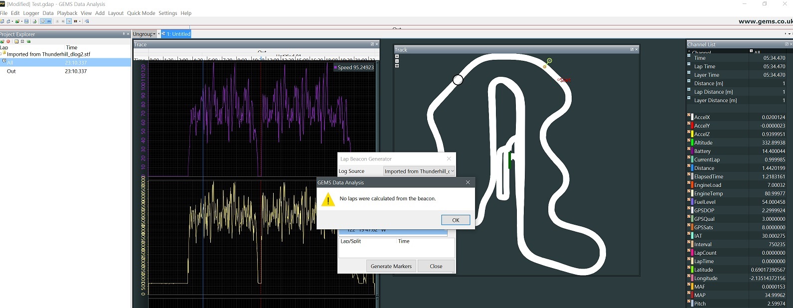

Yeah, i followed the instructions, but no luck.. i've attached a screengrab of the error code..

OK, thanks! finally figured it out, it was an issue with setting the lap beacon range and time window to sometime much smaller (the defaults overlapped the entire range of the log file). still need to work on adding the beacon at the exact start/finish line, but will work through that.
