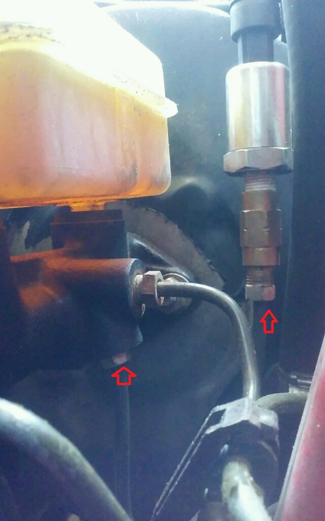

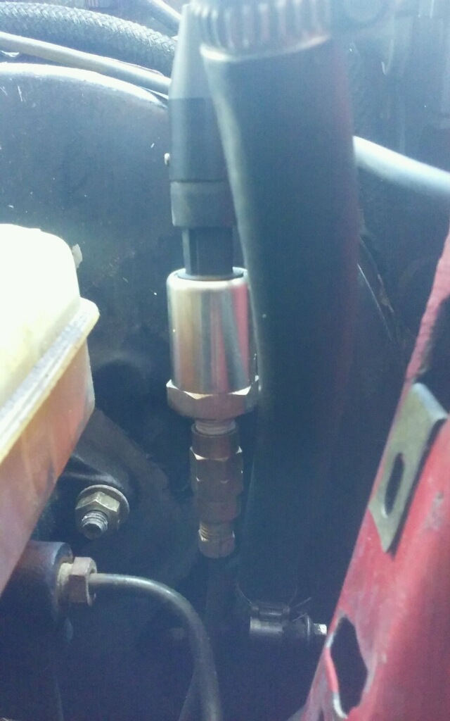

We also installed a break pressure sensor the 150 bar that Autosport sells. There is an additional port on the bottom of the master cylinder; an adapter is needed to go from 1/8 NPT of the sensor to M10 on the BMW. For convenience we installed a 10" break line from that port and bended it upwards so that the sensor visible. It also works perfectly.

See the pictures attached for our break pressure set up.
We connected a 10mm bubble flare on a small break line to a free spot on the bottom of the pump. And then a 10mm to 1.8 NPT adapter at the other end.
- Break sensor 2.jpg (128.03 KiB) Viewed 18523 times
- Break Sensor1.jpg (126.45 KiB) Viewed 18527 times
