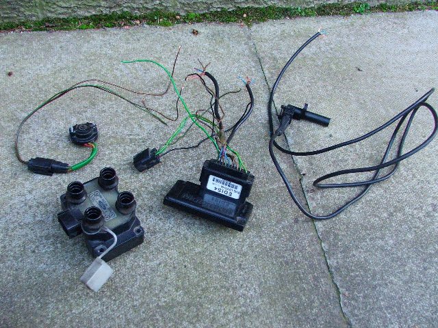

79 lotus esprit
Post by semi42 »

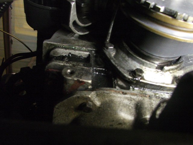

components from a ford fiesta

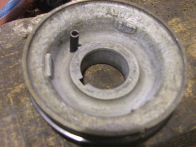

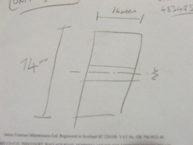

engine pulley is aluminium so a spacer was needed, dimensions given to local machine shop

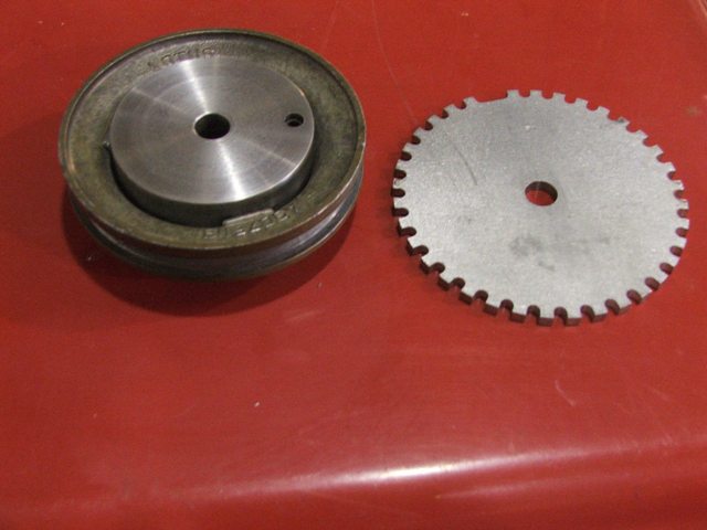

Post by semi42 »
spacer fits neatly in pulley and locates in dowel pin

Post by semi42 »
pulley, spacer and trigger wheel in place. spare bolt hole and sump bolts will be used for vr sensor bracket

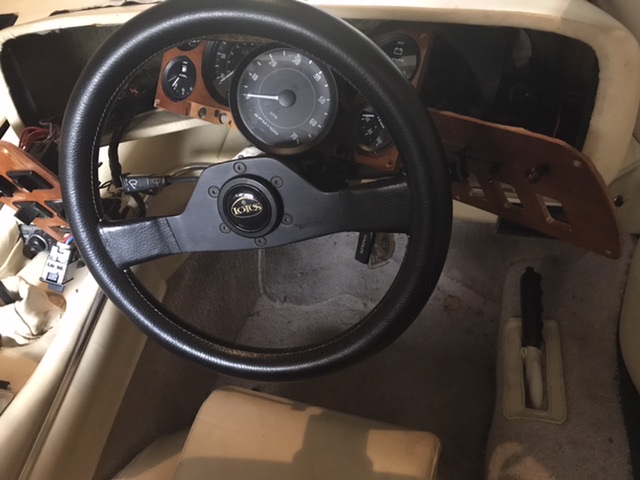

Update
Post by semi42 »

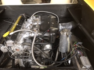

11 years on from the initial installation and I still own the car and the mega jolt is still going strong.
The Tacho however never worked as I never got around to wiring it up
During this time of lockdown I decided to get the smiths RVC tacho up working, along with upgrading the dash bulbs to LEDs.
Using the mega jolt Tach output didn’t work but splicing into the PIP lead got the needle moving
For anyone wanting to know about smiths tachometers, I found this quite helpful
https://www.triumphclub.co.nz/wp-conten ... Smiths.pdf

Update
Post by semi42 »
Better late than never.
