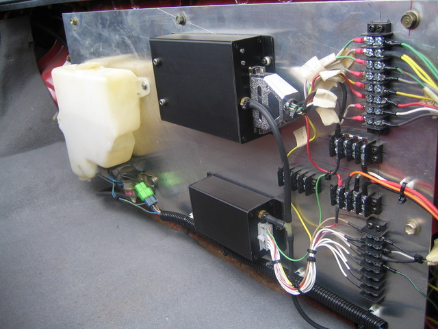

Neat looking MR2. I noticed that you have a megajolt and a megasquirt on this car. I assume that the 'jolt is doing sparks and the 'squirt is doing fuel. How are you driving the 'squirt? I ask as this is the long term plan for my Caterham crossflow, and i had assumed that i would have to loose the jolt to free up the sensors on the crank and tps (though as your car is turbo i guess you are running MAP), and run spark and fuel from the megasquirt.
Thanks in advance
Ian Brock
In the lab or in the car
Hi Ian,
Yep, the MJLJ is providing the tach input to the Megasquirt using the TACH_OUT signal. Works very well.
Here's a picture of the equipment rack showing both units. the reservoir at the end is for an intercooler sprayer, controlled by one of the MJLJ outputs (set by boost level). The MJLJ at the time the picture was taken is my first V2 prototype unit.
