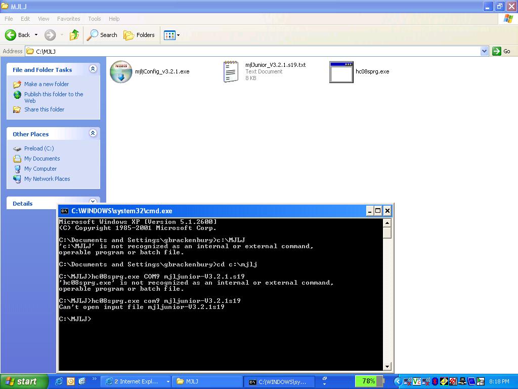

- Posts: 58
- Joined: Mon Feb 05, 2007 9:17 pm
- Posts: 58
A couple of problems.
1. Your web browser saved the MJLJ firmware .s19 as a '.txt' file (see the name of the file in your screen capture of windows.)
2. You mis-spelled the name of the file in the windows command prompt. "Can't open input file..."
Try re-issuing the command with the file name: mjlJunior_V3.2.1.s19.txt
