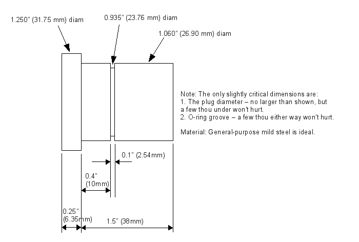

I used my lathe to make a steel plug to fit in the hole, with a groove for an o-ring - it imitates the outside of the distributor shaft. This is held in place by the same collar that used to hold the dizzy. If you have a lathe it's an easy job - if you haven't, then it'll take 10 minutes to measure the dizzy shaft and draw up a sketch, and a local machine shop can make you a plug out of mild steel.
I don't think that a plate would do it, as you'd never get a good oil seal.

Here's the diagram, for reference - I'd posted it on locostbuilders, but it might be useful here as well.
Apologies for non-standard format - I'm not a drawing expert! :D
David
