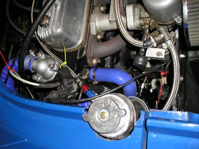

The program is from Race Technology and uses no sensors from the MJLJ. It uses a TPS attached to the carb spindle and a remote pressure sensor all logged at 100hz. Also has an input from the coil for engine speed (at the time this was logged before installing the MJLJ - now I use the coil input wire and configure the software as an 8 cylinder engine)
Details are here:http://www.race-technology.com/dl1_2_27.html
Pic shows some of the installation
26-5-5 small.JPG (85.18 KiB) Viewed 41449 times

Hello, Matnrach.
Where you live? I would like to have these blue for the coolant hoses, where can I get or buy?
Please send me an MP
