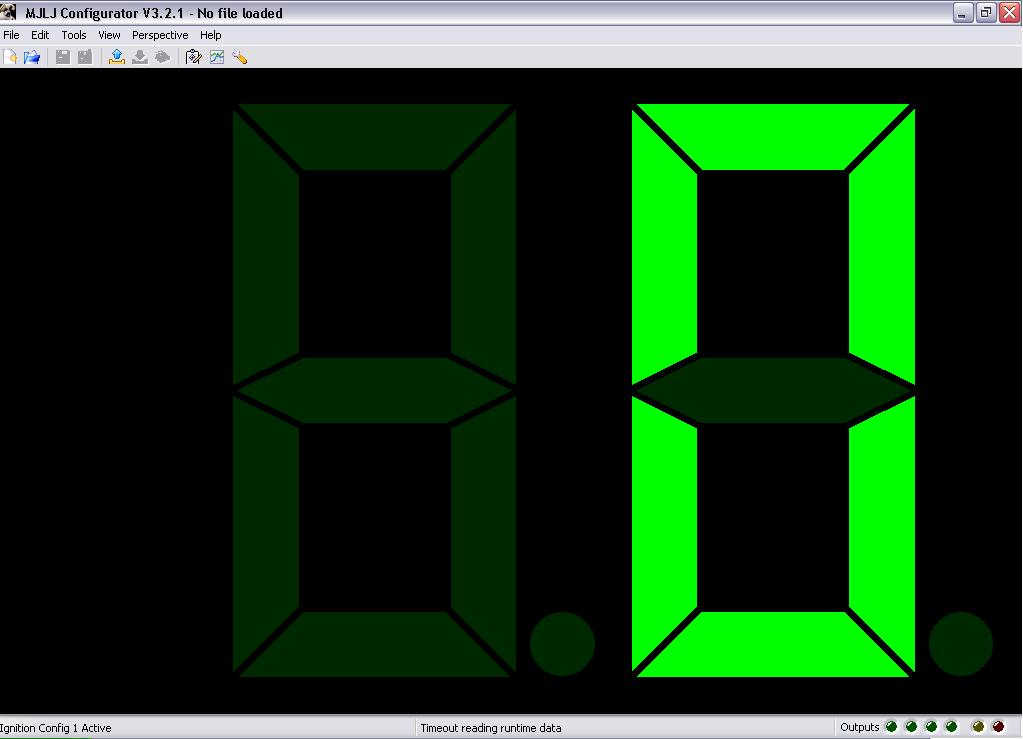

hey i opend my configorator and my data grid is gone and i cant get it back any idea?

Interesting - I just made mine do that too - by moving the horizontal re-size border at the bottom of the perspective view up as far as possible (ie just below the icon bar) :)
It's a little bit tricky to get it back, but this is what I did...
- 'tear off/undock' the gauges to outside the window so that the perspective view is exposed
- 're-dock' the gauges back into the bottom part of the main window
- if needed, resize all the gauges to the normal size
Looks like a "Reset Default View" might be a good menu option :P
Whoops! Looks like there's a bug to fix! :)

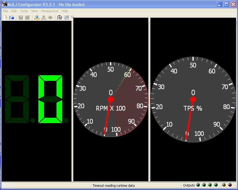

lol i cant evan drag the guages on that screen ther stuck, drivin me mad tryin to click em. Quite a wierd bug lol im a noob for doin it, im the person all programmers hate lol.

i think i may have now made it even worse. lmao

Oh my, it looks like your configuration software has gone completely mad! :) And worse still, I was able to easily reproduce it. :oops:
Here's the quick fix: download the attached file to your desktop, then rename it so that it ends in '.reg' .
Make sure the configuration software is not running, then Double-click the .reg file, and allow windows to run the file. This will repair the perspective settings.
I'll be sure to fix that in the next configuration software release!

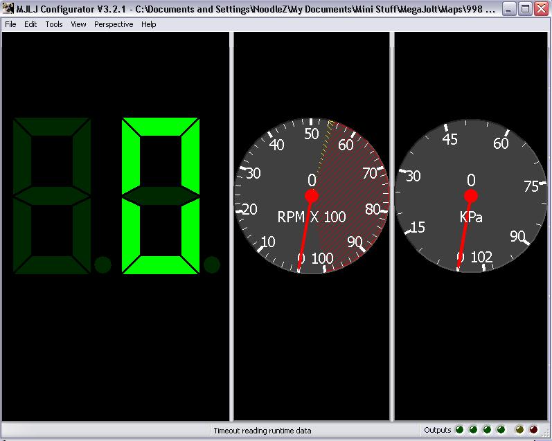

Downloaded and installed the "fix"
Set up Configurator with Perspective "disappeared"
Closed Configurator
Re-started Configurator
....started up exactly as it was when I closed it..
...but now I can't move the gauges at all - no drag capability any more, only thing I can do is change the size of the gauges horizontally
So my Configurator seems to be sub-optimal now :oops:
