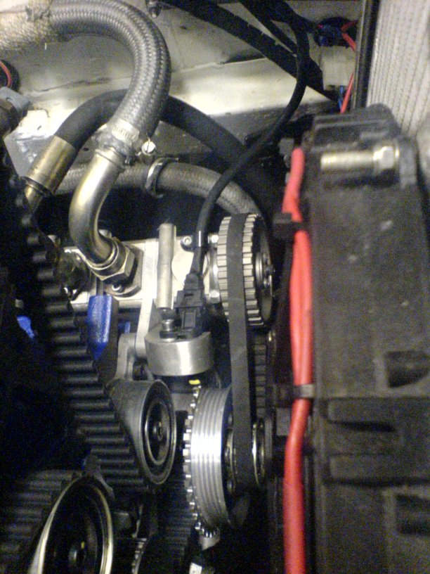

Again, not on a Vaux pulley, but here's how my Sierra trigger is fitted to the Mini'd crank damper with some simple lathe work. It might give you some ideas -
Assembled:
Shouldered:
The shoulder:
The trigger is a light interference fit, and held on with loctite and three csk screws.
Cheers for the pics.
Martin-That looks a very pro install. Dry sump eh, guess thats revving quite highly then?
Think the best way for me to do it will be like above, get both lathed so they are a tight fit, and then use a few bolts to hold it secure.
