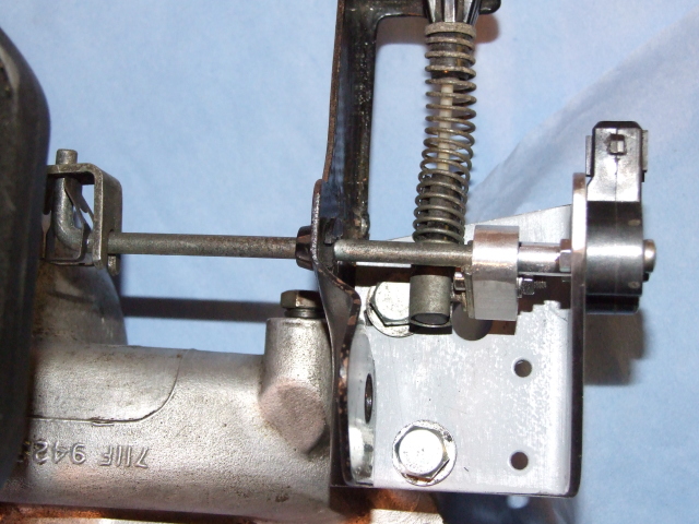

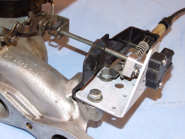

Well, I've stuck to my prediction! :D
I have attached a couple of pictures of my carb's new tps and bracket. It cost me about £5 including the tps and connector - not a bad result for a day's work!
The silver-coloured angle bracket is now in the process of being sprayed black.
