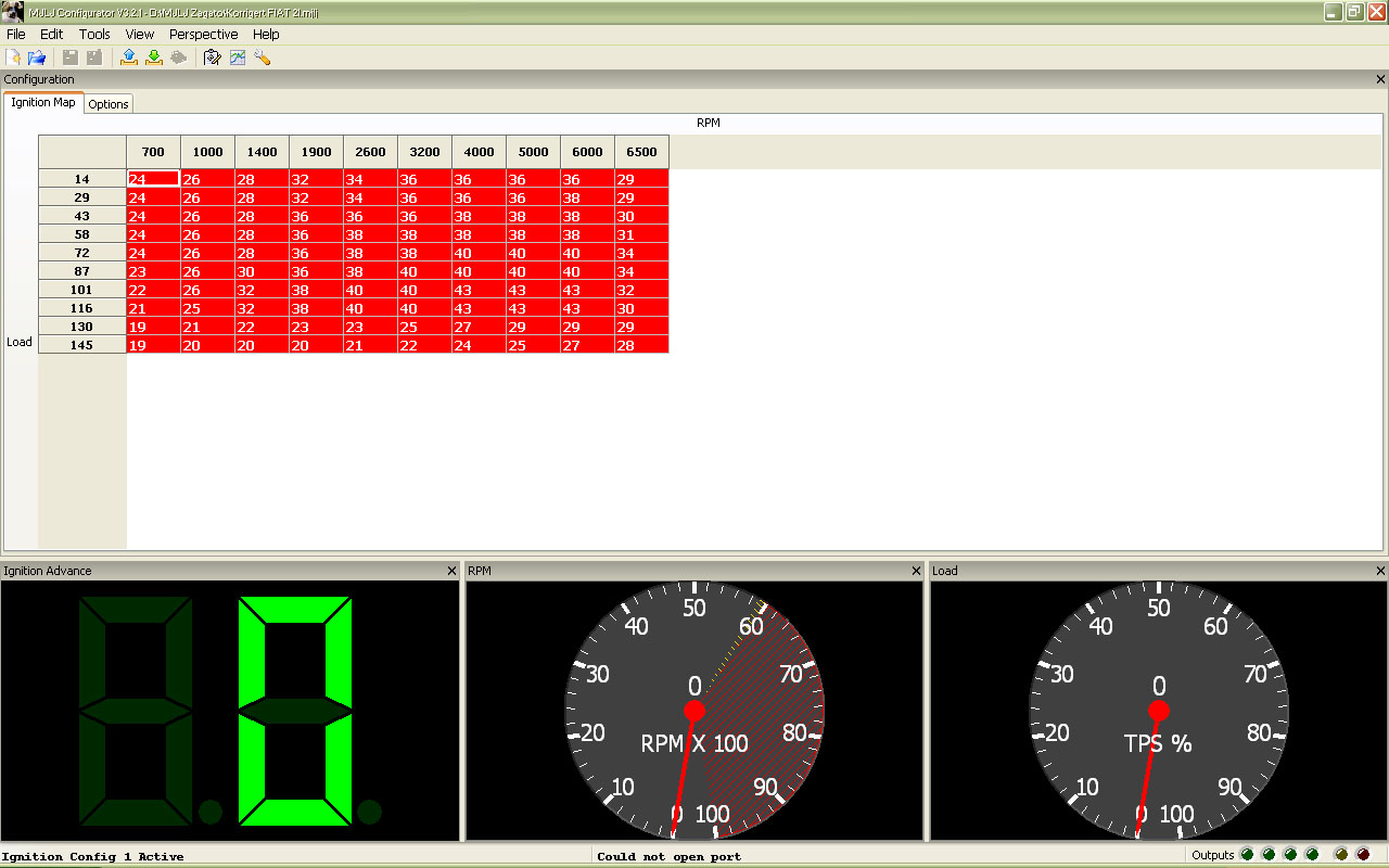

I get an advance value I don't even have in the table !?
Patriq
Posts: 161
Location: Oslo, Norway
Post by Patriq »
When trying to work out my table I drove around with the lap top next to me. Many times the advance dial showed 12, 16 and 18.
And the lowest advance value I had in the table was 19. How can this be?
I enclose a screendump of the table.
Patriq,
The flashed processor data and what was shown on the screen in the software might have been out of sync.
Next time you test this do a fresh read from the MJLJ after a power cycle and make sure your ignition map is correct. Sometimes it's easy to forget to 'flash' after 'updating' the MJLJ with new values.
If you still see problems, perform a datalogging session (datalog to file), then post a reply to this thread, attaching this datalog file along with your current .mjlj configuration file and we'll take a look at it.
