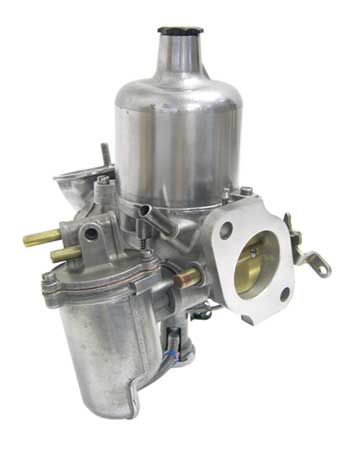

is a su hs4 with the vacuum niple actually on the carb

there are two versions, one thats not usable, like alexanders says. this is with the nipple a bit closer to the dashpot. and then there is the version with the nipple closer to the flange, this sees "full vacuum" all the time.
the last one was more common with the later Minis over here.
sadly, i have sold every carb i owned so i can not make any pics.

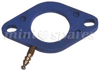

this has been buggin me now because i want to fit megajolt onto my road car and dont wanna mess about strippin manifolds off until i finish my new engine.
So would this solve the prob.
http://minispares.com/Product.aspx?pid=34395
New Carb Spacer for HS4 carbs with vacuum take off.
Gilesy998
Posts: 144
Location: Liverpoool, UK
Post by Gilesy998 »
That's perfect. If you have the stock mainfold spacer, just bin it and fit that one in it's place. The difference in thickness will make no differenrce on a road car. If you've not got the spacer, just stick that one in, but make sure the carb won't foul the bulkhead - my HS4 fouled when fitted to an alloy inlet fannymould, so I dropped the stock spacer.
luke6040
Posts: 113
Post by luke6040 »
well i have the stock spacer so i can do a straight swop! Im very happy now lol, iv gotta get it off anyway as its leakin like hell from there anyway!
I think this new spacer is small so should also give me a lil more clearance :lol:
Thanks for help
Luke
