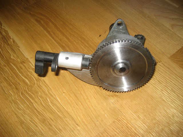

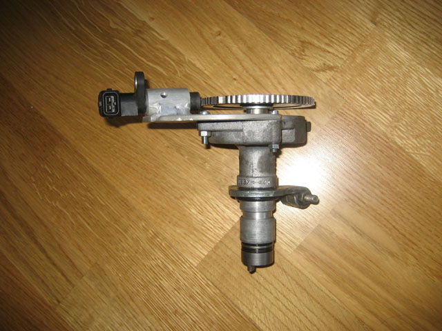

started on my second installation yesterday, this time in a 1968 Jaguar S-type. Had the trigger wheel
ready made up, and the sensor bracket (helps to have a spare engine on the floor to make this stuff

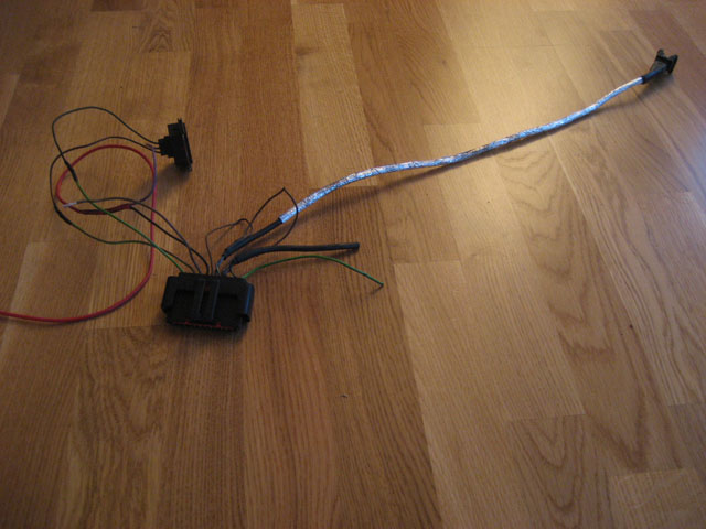

Hi !nickj wrote:Solved... Even though the sensor cable measured ok, I made it again, and this
time it sparked straight off. Boy oh boy, do I feel stoopid now

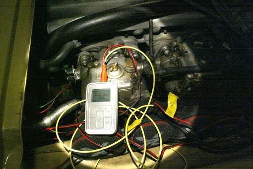

Sorting of having the same problem. Have everything installed. Tried both EDIS and MJLJ units by connecting the VR-sensor to a mp3-player and played a wave file that simulates a signal from the VE-sensor.
Both the EDIS and the MJLJ worked flawlessly.
Now when connecting the same VE-sensor cable to the VE-sensor in place. I get no spark.
Since I connected the MiniDisc player to the contact that goes directly on the VE-sensor - I'm pretty sure the cable is ok. I did this just by sticking wires directly into the connector.
Now, I might have switched polarity wrong. But the colour of the two cables on the sensor cable exactly matched the two colours of the cables coming from the EDIS-connector. So I matched these colours.
If nothing else - I'll open the cable. But I did a thorough job with a crimp all over both the lenghts of the sensor cable and the connector cable end in one piece which is a screening crimp connected to screened pin on the connector.
I'll try to confirm 2.3V AC on the sensor cable when cranking just to see if the sensor is ok to start with.

i bought my edis8 from the good 'ole U S of A via an ebay seller, along with a VR sensor and pigtails on both... setting it all up on the lathe before proper fitment, the blue/grey VR wires were connected to the corresponding edis colours and it didn't work!
reversing the blue/grey wires had it working! so the colour of the wires doesn't necessarily help or ensure correct orientation!!!!
on a side note, i did wonder if the actual physical orientation of the VR sensor has an effect? (ie. if mounted the other way around to the stock ford orientation!) not that i bothered checking, as it all worked how i wanted it to!
not sure if that makes sense, but i know what i mean! ah..... looking at the dizzy above, would the sensed polarity change, and hence the wire orientation, if the sensor is rotated in it's housing 180 degrees?
Orientation makes no difference....
The key aspect of the VR sensor output is that there is no negative-to-positive transition as the missing tooth goes past (see http://www.bgsoflex.com/mjl/mjl_edis_summary.html).
The EDIS contains a positive to negative transition "detector" and it can recognise when there is one missing and hence when the missing tooth has just gone past
If you get the wires the wrong way round, then there are always negative to positive transitions fed into the "detector", even when the missing tooth goes past (the missing transition is a positive-to-negative one but that is not detected). So there is no indication that the missing tooth has gone past, so the EDIS can't do its job....and no sparks ensue....
Ok,
I measured nothing from the VE-sensor. My voltage meter for AC is 200V or 500V only though. I don't know if it is sensitive enough.
I also measured the PIP pin coming to MJLJ. Not cranking it shows 12.7, cranking it shows 10.5.
There is 12.8V coming to both EDIS and MJLJ (same source cable).
For the record, I tried to measure AC from the VE-sensor whilst cranking with a remote controller.
I opened the cable and switched polarity around for the VE-sensor, still nothing.
Then, to confirm I again tried with the mp3-player playing a signal to the EDIS via the sensor cable. First nothing. Regardless of polarity. Turned up volume - still nothing.
Now I was worried that I had fried something in the EDIS. Checked earth, +12.5V etc. For the last time I cranked up the volume again on the mp3-player. Then - BINGO ! Spark.
So system is intact. Also cable from VE-sensor since I'm feeding the signal from the mp3-player via the cable.
So I've come up with these alternatives as to why I'm not getting spark:
1. The sensor is not in good order. I bought a new one when I bought a complete package from trigger-wheels.com with EDIS units, cable etc.
Is there a way to test the sensor - without the wheel ? Could it have been damaged ? Are they fragile ?
2. The trigger wheel (and its teeth) is to small to generate a proper signal, at least while cranking ? I don't belive this is the case since I've seen an other installation here that uses a much smaller wheel (Alexander's)
3. The signal is to week. Since it only worked with the mp3-player when I really cranked up the volume. Maybe the signal is to week. But... the sensor is stock Ford, and so is the cable, and the connector to EDIS. Can you measure signal strenght ? Maybe an amplifier would do the trick ?
4. The cable for some strange reason lowers the strenght of the signal from the sensor (not likely, but "possible")
Anyone care to comment ?
