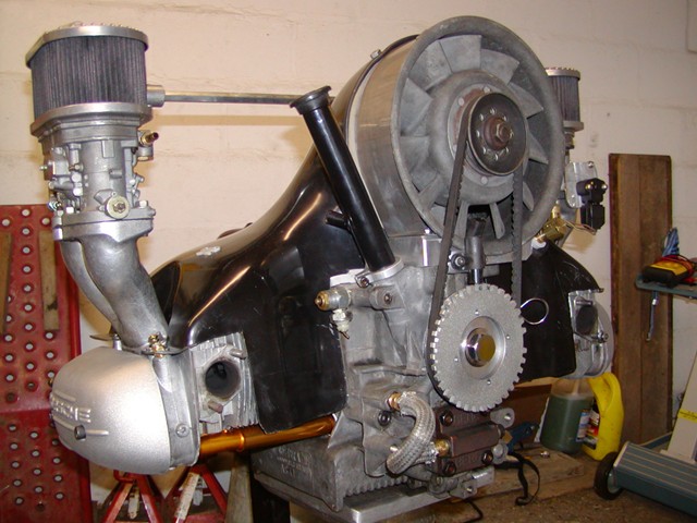

VW type 1 aircooled flat4
2165cc, 78mm stroke, 94mm bore, built by Jake Raby of Aircooled Technology
Webcam 86B, Headflow Masters 040, 44 X 37 mm valves
Pauter 1.5:1 roller rockers, Weber 44 IDF X 2
4-2-1 exhaust w/dual Magnaflow mufflers, 3" exit

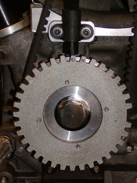

It has 10,000 miles on it on a dizzy, now the Megajolt is installed and working!
I am very pleased, thanks a bunch Brent!!

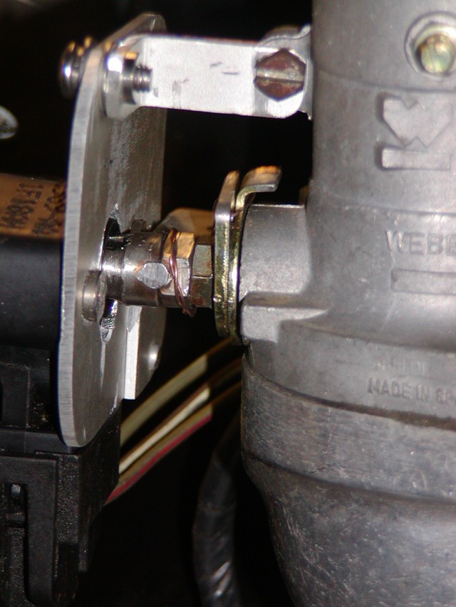

Paul, I chose TPS because I didn't want to drill and tap the manifolds. I also didn't want extra hoses and a vac reservoir in the engine compartment. It is busy enough already. It was kind of a pain to make the TPS bracket but the TPS came off the donor Ford. Three wires and a bracket for me is easier than a bunch of hoses.

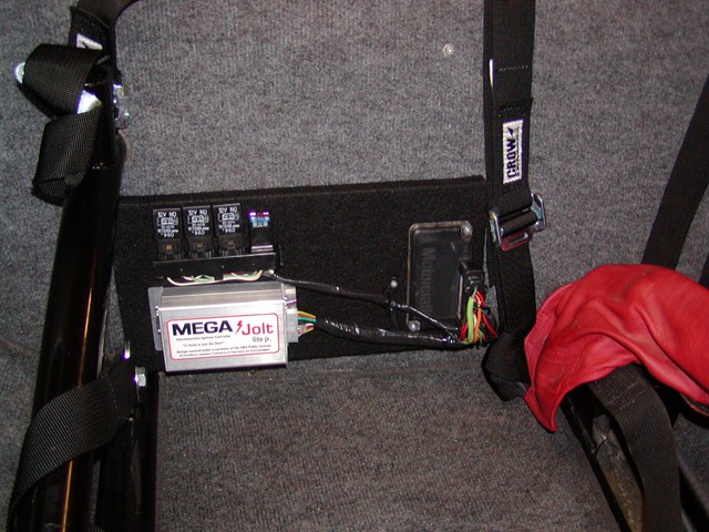

Update to the car. Still running perfectly. The ignition is hands down the best mod I ended up doing. Almost 27,000 miles now. It was around 10-12,000 when I installed the ignition. I ended up making a three-light sequential limiter by using three rpm outputs. I used another output to trigger a 12v solenoid that opens up a crankcase evac exhaust venturi above 5000 rpm. Also wired up temperature compensation(a bit more advance at low rpm when cold to increase the idle speed). I have spare new EDIS components in the car, just in case. Dual maps, one for good gas, one for bad.
Kudos to Brent for a VERY flexible, reliable product!
