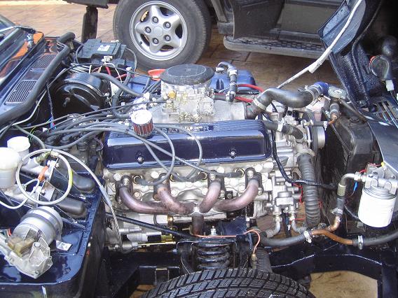

I've been running my Rover v8 with weber 500 (4bbl carb) for 300 miles now, and worked out i have no better fuel economy than with a distributor.
I haven't got around to connecting up the MAP yet, so am running on 2d only.
I'm wondering (back to basics) will MAP and remapping give me more mpg? or do i just trim back the advance a bit in all ranges?
currently 16mpg aint too good even on a 3.5 ltr.
People on rimmers site etc are claiming 25 with the same weber and a distributor.
cheers chaps.

yes, with connected MAP sensor you can get much better mileage at part throttle (assuming you full throttle curve is correct, if not tweaking it will help, too)

Yes, for sure. You need vacuum advance for best fuel economy. In general, more advance for more fuel economy. Just don't let the engine ping/pink/rattle/detonate.
I would think a well sorted distributor will give as good of fuel economy as MJLJ. But due to emission control and factory tolerances, not many do; you'd have to blueprint a distributor to be sure. Not to mention most 20 year old vacuum advance units are plain broken. With MJLJ, it's easy to reconfigure the curves.

changed rods 1 more stage leaner today, will test this week.
3mm vacuum hose ordered now.
I'll be back when i screw up my ignition map later ;-)
samco hoses now where the old ones are. and i even have an airfilter now! yaay
