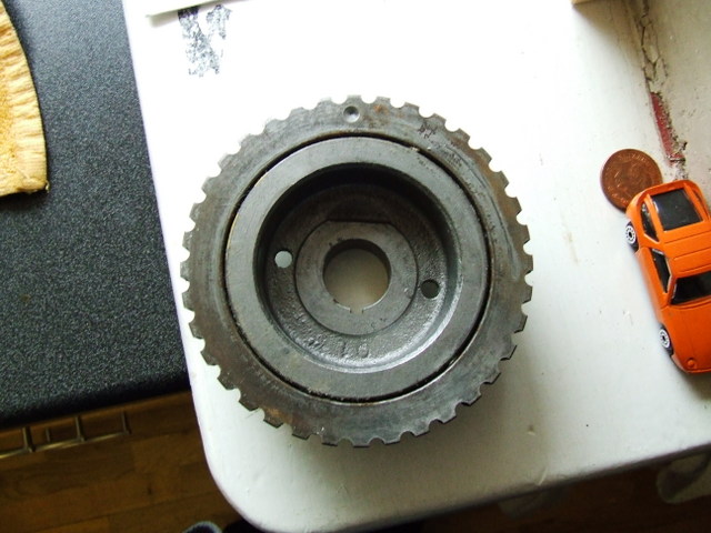

The EDIS module may not be getting a strong enough signal to keep sync with the wheel pattern you machined. Is your pattern as deep as the typical Ford EDIS wheels? Post a picture if you can.
Does the pulley allow for a deeper pattern?

The pulley has grooves about 3 to 4 mm deep and semicircular in profile. I shall get out the Dremel and make the profile sharper. The grooves can be made deeper as long as the small grinding wheel holds out!

So it sounds like the teeth needed to have a larger difference to generate a strong enough AC signal and see the missing tooth. Yes, where the sensor is in relation to the missing tooth will determine where the EDIS thinks TDC(and 10 degrees before) is.

Yes it would appear so. My pulley was machined as a copy of this wheel (see pic). It would seem that the sensor benefits from steeper sides to the teeth. Hopefully moving the sensor today to get the 10 degree timing. We're getting there!
Steve
Machined 'A series' crank pulley

I might be missing something but that wheel appears not to have a missing tooth.
Would this cause the random advance settings?

The pic was taken before the tooth was removed. I he did like me, he would have ground the relevant tooth out after the pulley was on the engine and he could determine which one to remove after mounting the sensor. I would suspect that the EDIS would not produce a spark without the missing tooth.
