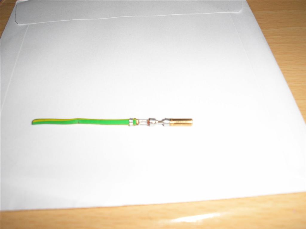

Hi all Newbie question again :roll:
looking for the crimp on connectors for the edis module
does anyone know where they are available to buy?
or even the correct name for them?
Phil

Those crimps are unobtainable I'm afraid. I'd love someone to prove me wrong though.

Bullocks!!
oh well just have to get handy with the soldering iron

Just an update.
friend is a ford tech and he thinks he can get them as part of a repair kit.
watch this space.

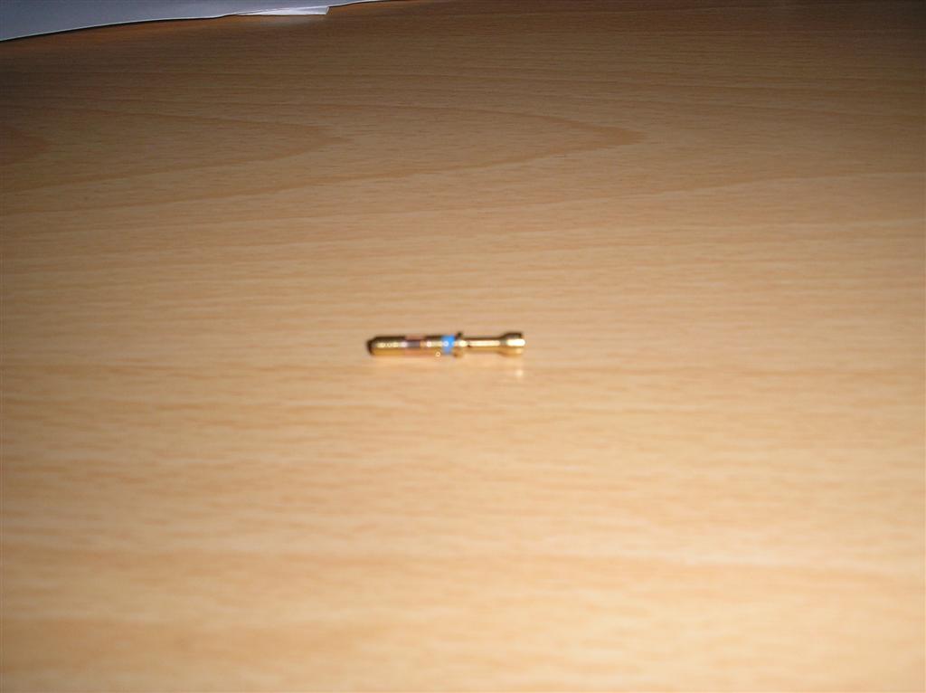

no joy with ford crimps only come as part of a very expensive repair kit!
My friendly spark gave me some other crimps he had in his box not the same but they fit and it fires up
so im pleased!

do you know the name of these crimp terminals?
thanks

Post by philbert »
Alexander sorry i dont know the name of these crimps.
mates on holiday for 3 weeks will quiz him when he gets back.
