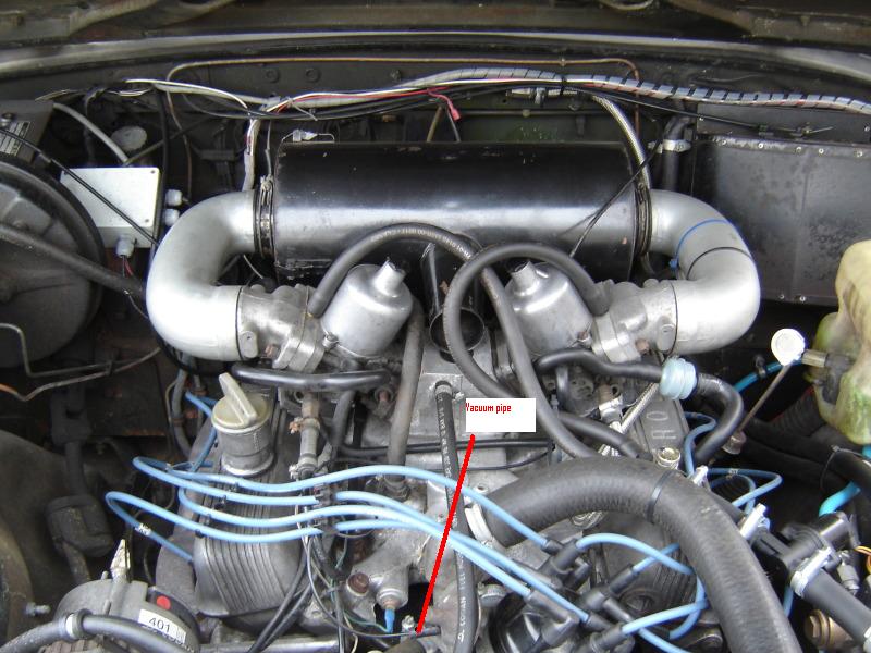

Guys,
I have ordered my Megajolt (MAP, not TPS) and am eagerly anticipating its arrival. I have everything else ready so am thinking about how i am going to go about installing it all. :o
The vehicle is a Landrover 90, and it is fitted with a 3.5 rover v8 running SU's. This is to be changed for EFi later, but for now i have the SU's, so have to deal with them... :shock:
So my question is this:
What am i best doing in terms of tapping into the inlet manifold for the map reading? Tapping into all 8 branches is going to be a nightmare and look pretty messy, so can i get away with only doing a couple? What would happen if i took the reading from where the brake servo takes its vacuum? I assume that this would mess up the MAP reading when you applied the brakes and vacuum dropped?

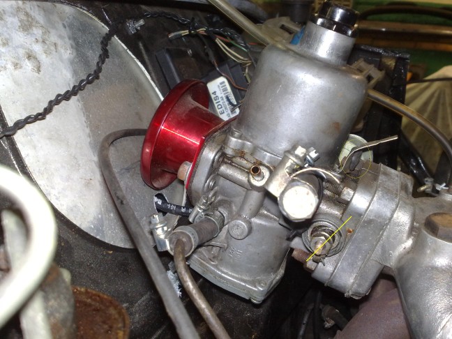

On the inlet manifold, the "lump" the two carbs bolt to is an ideal place to tap for take-offs. If the carbs feed a separate bank each (I forget how the stock RV8 manifold works), then one union fitted after each carb, to a small reservoir, then off to the ECU would be perfick.
On your second pic, there's a hose fitted just to the front of the carbs, somewhere there is ideal.

this pipe going to your dizzy is the vacuum advance... its just a vacuum pipe from the carbs i would just use this as you won;t need it using megajolt... any area behind the throttle plate will give you the same pressure reading as it the throttle plate that allows air to pass into the manifolt (as you probably know), so you can drill and tap a hole if you want or just use the exsiting vacuum take off from the carbs....hope this helps
