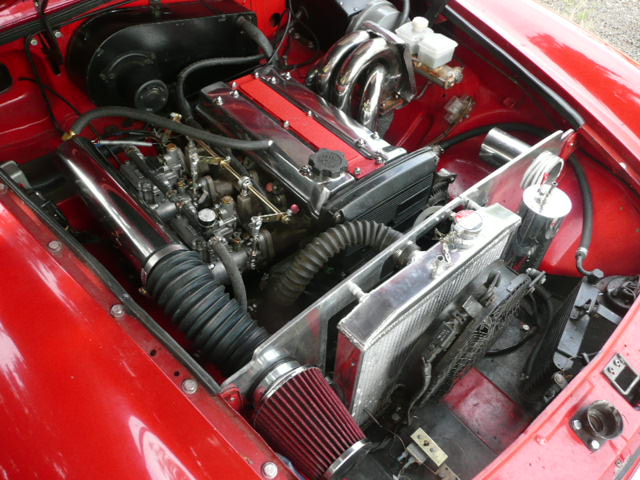

Toyota 4AG 16V swap into my 1970 MGB GT
Toyota T-50 5 speed trans.
Narrowed GTS disc brake rear axle 4.3 A 4.77 lsd 5 link comming soon
Dellorto 40 side drafts on HKS 8 port intake
Stainless turbo under mount header gets exhaust around steering (just)
GZE block 10.3 comp pistons
adjustable cam gears
212mm lightened fly wheel with ACT street comp plate and disc.
EDIS4 with MJL (of course)
Alum rad and custom alum core support.
Stainless cold air intake /silencer
Ignition is is concealed under the carbs and plug wires routed under cam valley plate.
Some mods include deleted side markers, back up lights and MG hood bulge.

How are you using the output to control the TVIS? IIRC, TVIS was built into the intake manifold...

The TVIS is a separate unit between the intake manifold and the head.The HKS manifold has 8 ports and matches the 30mm ports on the TVIS unit.
I use a user output inverted to on and set to 4,000 RPM (or whatever) to switch it off. Off opens the vac sol and the butterflies.
The TVIS control is low draw and needs no relay, it's always on until rpms reach the set range then opens up as it's switched off.
Throttle response in low revs is much better and flow seems to just fine in high revs.

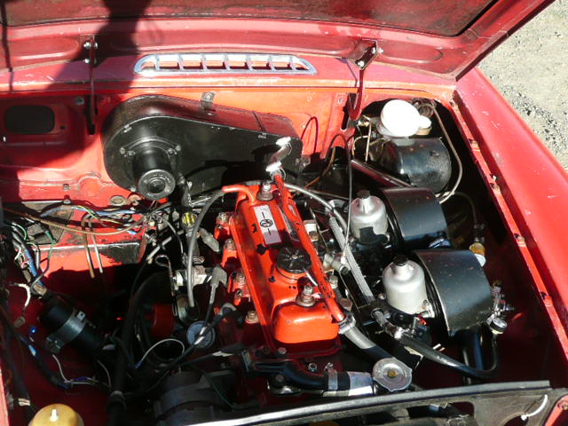

Before
Before
