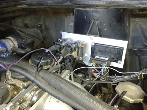

Last year i collected the hardware to start my Megajolt project. Peace by piece i got all the parts i needed. Now the time is here to put things toghetter to see if i can make it work.

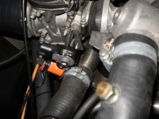

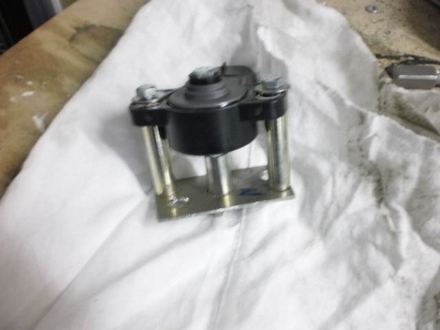

I am building my Megajolt with TPS. I did have a TPS for my Mikuni's, it turned out to be the wrong model. I made a bracket and punctured the TPS. I looks like it works allright. We'll see.
I have a spare engine. I could use this to figure out the best way to place the crank sensor. I have a bracket thats connected to the engine mounts. It's quit stable.

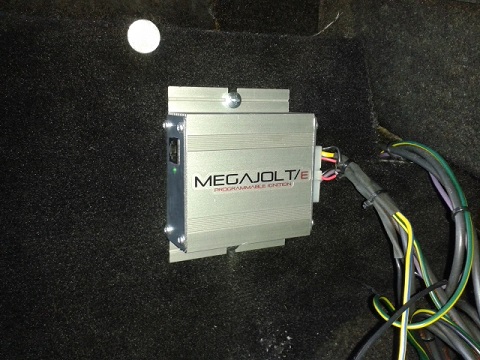

here some more pictures
