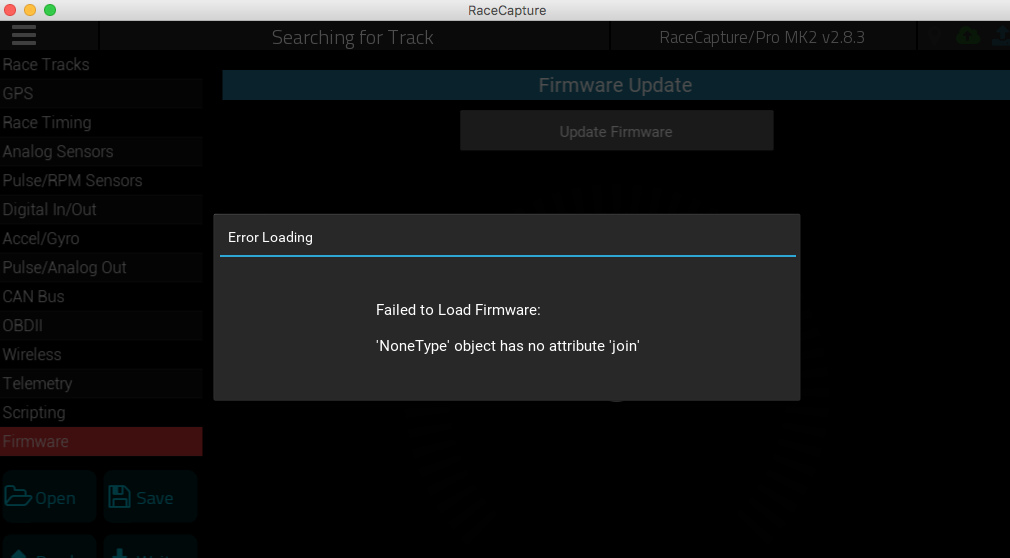

Im trying to update the firmware and getting an error message...
error message
error message
Screen Shot 2017-05-14 at 8.17.24 PM.png (58.56 KiB) Viewed 7146 times

I downgraded the APP version. I no longer receive the error message, but still can't update the firmware. Now the device start blinking red, but no progress is shown.

I can't find the thread, but I think this is MAC related.
Try using a windows based computer and see if you run into the same issue.

boggie1688 wrote:I can't find the thread, but I think this is MAC related.
thanks for the info!
that may be a problem for me, I don't own a Windows computer. :cry:

Post by boggie1688 »
Try bootcamp?
Although you'll still need a copy of a windows OS.
You can do what I did, I bought a new laptop dedicated to the garage. Nothing fancy. There are plenty of sub 200 dollar windows based laptops available on Amazon. IE: https://www.amazon.com/Lenovo-Premium-P ... 2035945011
If your going to be working on the car enough, it is worth the investment. Otherwise you'll be stuck borrowing a laptop every time you need one. You could also buy a copy of windows and boot camp it. Not sure if that will cause any problems or not.

boggie1688 wrote:Try bootcamp?
I have been able to resolve 98% of other systems issues with Parallels (the only item still not working is the AIM WIFI connection for data downloading).
I did try that last night, but, it didn't recognize the RC device.
I still have some more to try, but getting out of options quickly.

2.11.0 up & running!
borrowed a Windows laptop and upgraded the firmware in the 1st attempt.
now trying to sort out the next problem: Cellular Error initializing :cry:
