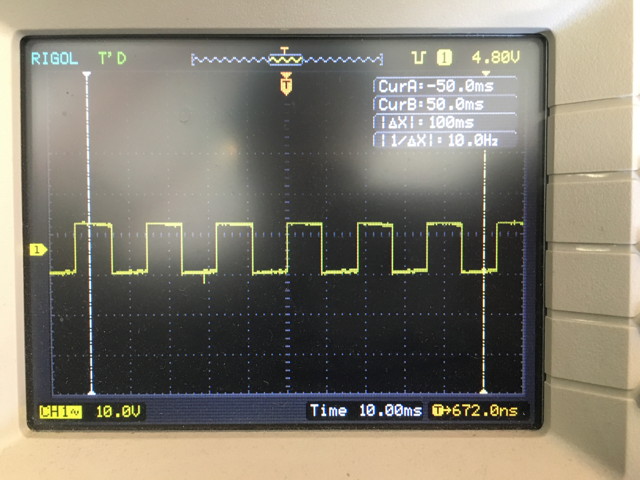

Tach output from a Siemens MS41 (BMW E36 DME) direct to the RPM1 input. I have a nice 12V square wave (attached) on the pin, but the dash display / telemetry never show any signs of life.
RPM1 is configured for RPM, 10Hz, input. Firmware is current.
Anything else I can check?

Can you attach your current configuration so we can review it?

I think I found your problem. You have a 2nd channel also called RPM, under GPIOs. Please rename or disable this channel, write back the config, and see if you get RPM data on the timer channel.
