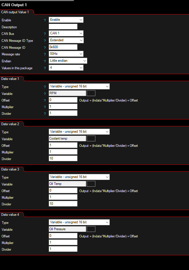

I´m new with the ASL product and i think i missing something behind the CAN ID.
I using my own protocol and it starts like this. (See picture)
How should i start in the Race Capture software to make this work?
And one other thing. In the Maxxecu preset CANBUS, why is there only 8 channels?
I using pro mk3
Thanks.

I do not quite understand your question. The CAN ID in RaceCapture is the same industry-standard CAN ID you would find anywhere. It is defined in decimal format.
We have an extensive guide here on it: https://wiki.autosportlabs.com/CAN_Bus_ ... ID_and_bus
The MaxxECU has 8 common channels. You are free to add more channels as you see fit, using our easy-to-use interface.

The problem was the Decimal format and Maxx uses Hex format.
I think here in Europe the Decimal format is pretty uncommon.
