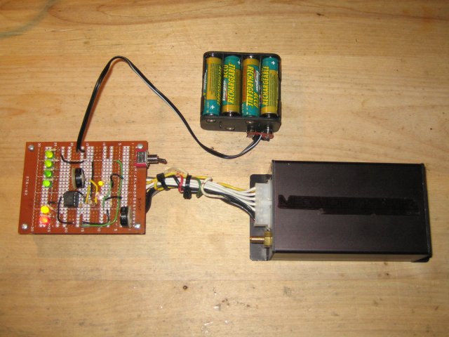

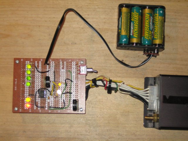

Here's something I knocked up for fun - just connect +12v to the connector near the Molex, the Molex into the MJLJ and the computer to the MJLJ and the rest should be self-explanatory from the picture!
Only components are the LEDs, some series resistors and an Atmel AVR (ATTiny13 - about GBP0.75) with about 75 lines of assembly code....

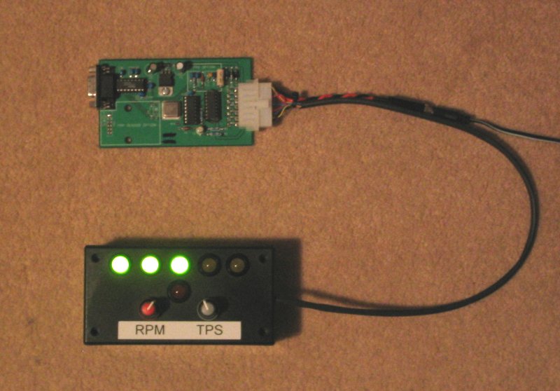

Looks neat! I'll post pics of mine, but yours wins in sophistication, I only used a 555 timer to stimulate PIP. :wink:
I'm also building a new test bench for more elaborate testing, I'll post pictures of that as well!

I used software so that I could get the rpm (500-8500) to be linear with the pot rotation - the ATTiny13 has an onboard ADC, so I thought I might as well use it!
It's not really a test bench, since it doesn't take any notice of PIP - that's the MkII version I suppose
It also, obviously, only does Engine Load as TPS - I still have my trusty syringe and windscreen washer pipe for MAP :)
No kidding on the non-linearity! the last few 1000 RPMs are a bit touchy!

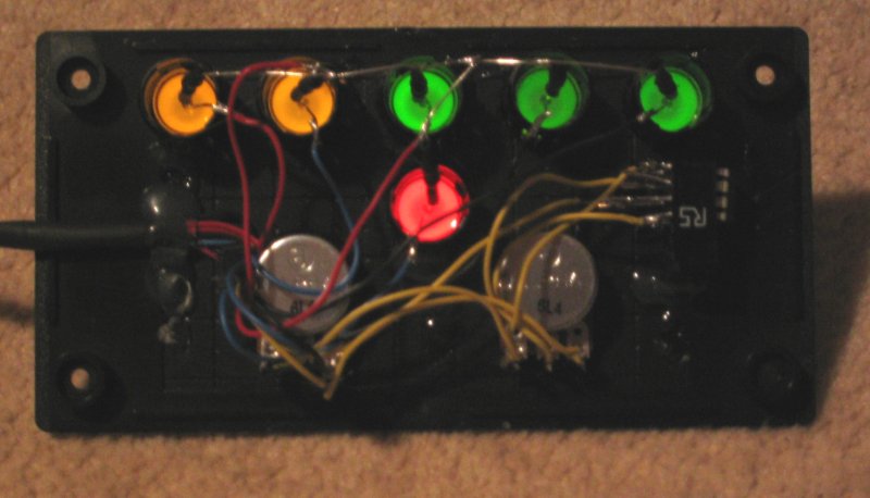

I've attached pictures of my abomination :D it's not pretty but it does the job. The MJLJ unit it's attached to is the grandpappy first MJLJ v2.0.
You know what works great for testing the map sensor? One of those rubber bulbs used for clearing an infant's nose. Cleaned, of course. :D
stimulator closeup
stimulator closeup
stimulator
stimulator

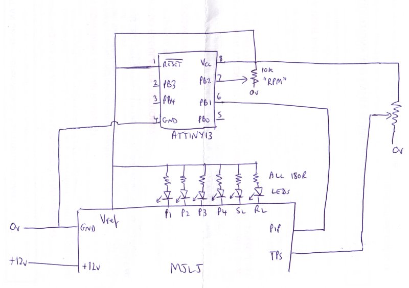

If you have a schematic handy that would be useful, but with only 8 pins, I'm sure I can figure it out if its not convenient.

Circuit diagram please :)
Post by jonboylaw »
I also would welcome a circuit diagram.

Sorry chaps - completely forgot :(
Here's a very badly laid out schematic on a scrappy piece of paper inelegantly scanned...
