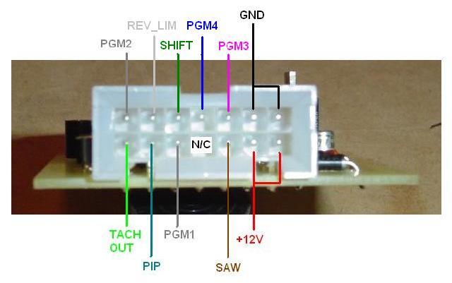

I have the Map MJL, is the below pic correct (in realation to the power and negative which replaces the TPS) or does the TPS points stay blank(empty)?

Were you just looking for the correct pinouts, or are you planning on doing any mods the the board, or convert it to TPS?
Here's the official pinout for the unit (your image shows a V2.X board - is that what you have??)

No - not correct.
Only connect ground to the upper right and +12v to the lower right.
Leaves the others unconnected for a MAP installation
(it actually won't do any harm I believe (seeing that the TPS option components aren't installed), but if anyone connected a TPS MJLJ into your plug, smoke would be let out...)

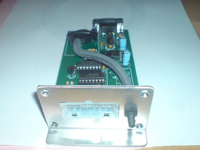

Brent, Thanks for the reply, I have opened it up and on the circuit board it states 2003/2005 V 3.0.0
I assume this is a V3.Board?

Very well, then the 3.0 wiring diagram is the one to use.

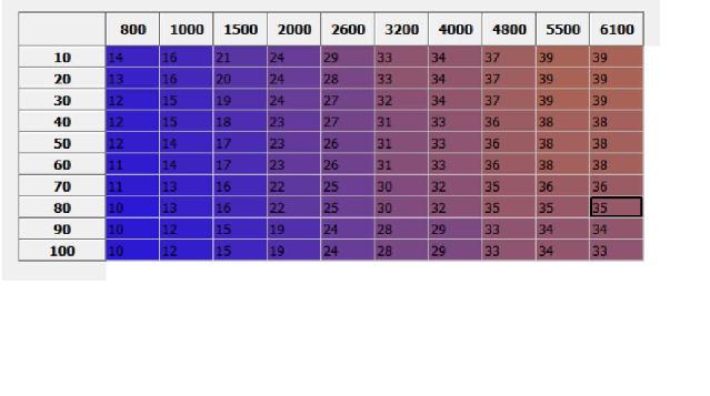

It was the sensor leads back to front! I am using my own starter map fir the Triumph 1300. (Spitfire) Attached.
